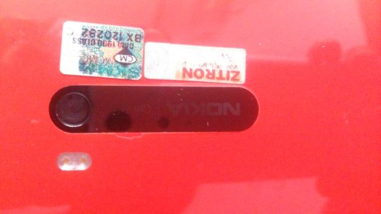

I just noticed that the back part of my phone(around the camera lens), the cover is peeling off...so, the most outer layer of the body is gone and I can see the inner part of the body which is not shiny...how to stop the outer layer from peeling off???

I had my L920 in a yellow casing for several months and now about two months in a red housing. I am always using a Nokia charger at night. I have not observed this on either the yellow or the red (yet). Note, I am not referring to a protection case but the actual housing of the phone.
I would think these are isolated cases of a housing with a defect and I'd agree to contact Nokia about it. It looks like a problem with the polycarbonate not having been tempered (annealed) correctly and it caused a skin layer with different pre-stress (probably cooled too fast when it came out of the mold). Heat will cause this outer layer to crack off the main housing body over time. This will first happen at the weakest points with most stress, which is at curved openings. Note that the camera cover is actually sitting on a layer of PC, so there is a sharp step where the camera cover is laid down.I would exactly argue this with Nokia Care.

You can see what happened in this photo:
The photo is not very good, but this is all I could get now.
P.S; I meant that I had Nokia CC-1043 on, and when I pulled it off I saw this.

EDIT: it is seen much better here I think:
I can't tell if that's a peel or chipping from being dropped.
That's clearly peel, where it was dropped you can see dents, but not on those photos.
And most of this peel was made when I had the original nokia cover on.
