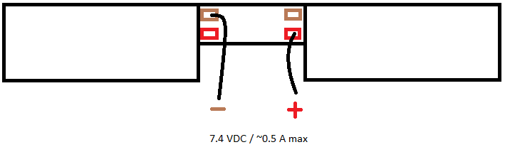

I had this problem for years - until tonight! I thought it was time to win or loose this contest forever! So, I ripped off the back of the keyboard (according to previous description above) and removed the battery. I started a power supply, set it to 7.4 VDC and limit the current to about 0.5 A. Then I removed - gently - the middle plastic lid of the battery (cutting some tape etc.). Here beneath is found four battery pads where I connected + and - from the power supply to two of these pads. I connected - to the pad that is shorted to the black connector wires, and + to the opposite diagonally placed pad. The two other is just shorted in between to make a series connection of the two batteries. I let the charge of the batteries proceed until I could read about 6 V across the batteries. Now I reconnected the battery to the keyboard, and - Viola - the 2nd battery was finally taking charge! Still showing 0%, but anyway "Charging". After a while the % started to increase and all seemed being solved! Just a tip if trying this, when refitting the battery, just check that all flat cables are fitted in their respectively connector. Do this by pushing some keys and swipe the mouse pad and find there's any response before putting the keyboard back on again. It's just so irritating to be forced to remove the back once again...
So, as someone above described, it really seems like the Windows driver for the battery don't let the 2nd battery be charged if it's drained too much!
