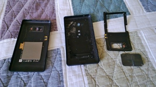

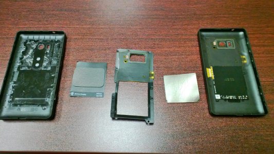

So I got the OEM Nokia Qi charging back for my Lumia 810 yesterday and I just wasn't happy with the added 2mm or so. Call me OCD I know. So this morning I proceeded to move the Qi coil into the slimmer back that comes with the 810. It was super easy and just took about 15 minutes of patience and a small flat head screw driver. The breakdown process is fairly straightforward so I won't go into details. You can see from the pictures what parts came out of the back. On the standard back I removed the little spongy pad. Also there is a little black piece of plastic on the back side of the 4 pin connector. You'll need to pull that little plastic piece off to get the case to be flush with the frame around the screen. **The only thing i've noticed is that its range of movement on the charging pad has gone down. I assume this is due to the removal of the silverish pad on top of the coil which probably helps in that regard**. It could just be combination of that and the smallish size of the Nokia Qi charging pad. Other than that, charging works great and no extra thickness.
**EDIT - I had to reapply that silver pad to the coil as I was noticing the charger was quickly disconnecting and then reconnecting if the phone was not completely centered on the pad. Now it works perfectly anywhere on the pad.

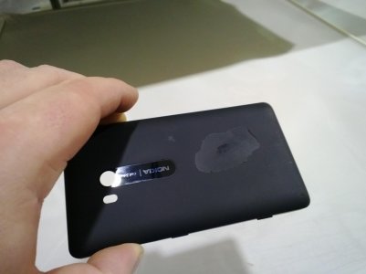

Without the proper insulation and thicker plastic, won't a mod like this melt the soft coat off the back of the cover like this?
enjoyfebruary
Feb 27, 2013
14
Visit site
I've been using the modified back solid for two days now and I can say at this point that I haven't felt the back get any hotter than if I had the phone in my pocket. Obviously there is some heat generated with the Qi system that is inherit to the technology but definitely not anywhere near as hot as it would have to be to melt the plastic. Not even close. Also, without any specific measurements the Qi Back and Standard back feel to be the same thickness in terms of the plastic they used. Confusingly they added some additional frame parts into the Qi Back which makes the back thicker. I'm not an engineer so there may be some specific details that I'm missing but it charges fine and in my experience does not get to any sort of high heat. So thats good enough for me.

How did you attach the pad it's just look likes it's laying there ?
Also wondering if the pad from a 820 charging back would fit and work,
they use the same battery and you can get the 820 charging back for $25.
PLGomez
Dec 6, 2012
367
Visit site
The pad just sticks with the original adhesive. I'm sure the 820 pad should work as well. Let us know if it works out for you.
