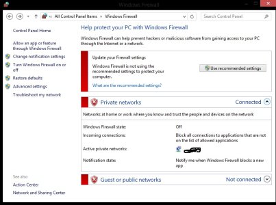

What to do next? I also turned off my Windows Firewall.

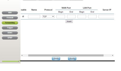

- In the "Name" space put something like "Remote Desktop" or "RDP"
- Begin and End put 3389 (Wan and Lan)
- Server IP is your laptop IP
Now, try connecting using 3G, you must use the external IP from your modem

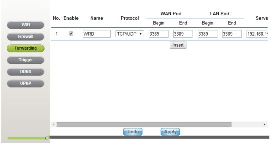

I already set my modem forwardings udp/tcp to 3389 and server ip address which is the ipv4 of my laptop.. Then I connect my phone using HSPA into the external ip address 125.xx.xxx.xx and the router but i am getting error 0x204 in Remote Desktop. Connecting to the ip address 10.x.xx.xx does not work.
But when I connect remote desktop of the phone into the same Home Wifi Network, I do not have any problem.
NOTE: The IP inside my Router is 10.x.xx.xx while in http://www.whatismyip.com 125.xx.xxx.xxx
