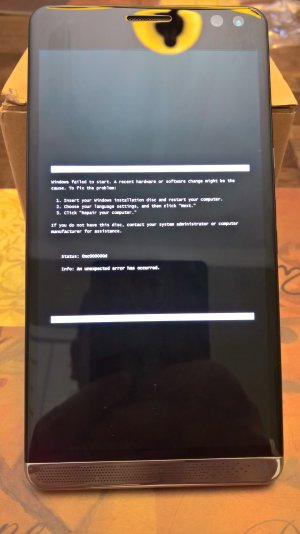

Wow this has been an awful experience... I've given the device nearly 3 months, and despite multiple factory resets using WDRT, testing with both Insider Preview builds (Release Preview and Fast) as well as Production builds, this device continues to be*unstable.
As of yesterday, I was having no issues with the device after having completed a reset using WDRT 3 days ago. It is on production build, not using a microSD card, not using Skype Preview for SMS, etc. And now - after it began another round of freezing and rebooting, I received the error in the attached image. I can't even get it into recovery mode so WDRT can re-flash.
I'm opening a ticket with HP but if anyone has seen this and has any advice on how I can get this working I'd appreciate any input. At this point I'm just going to cut my losses and get it replaced so I can get rid of it.
Hmm... that seems like a defect. I'm not an expert but I would contact the Microsoft Store if you bought it from them. You can get it refunded within 30 days if you're still in that time period. Best of luck, man.

Yeah - so HP confirmed there was some kind of milling issue with the sim tray which is apparently causing a lot of reboot and SD card issues. They are sending out replacements.
For me though, something else must have happened because I couldn't even get the recovery mode to start, so are replacing it. For some reason they couldn't confirm whether the replacement device would have the fixed sim tray though, so I may till have to request the new tray if I have similar problems with the new device. I'll test it, but for now I'm back to the 950XL.
