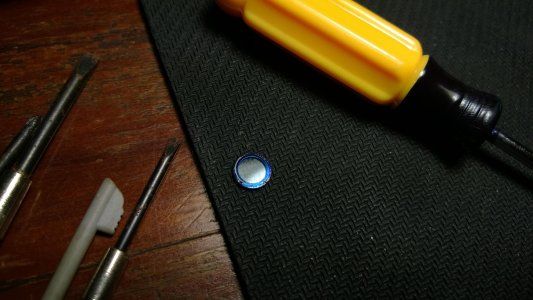

So, I decided to remove it from my 920 to avoid having to clean it every time, and avoid these ghosts and glare and gain a bit of contrast and sharpness. :grin:
Some may say that it's crazy to remove a protective element, but I think it's pretty safe as the real front element is now very "deep" into the body of the 920, so it's not easy to touch by accident, also it still has some dust protection due to the circular foam surrounding the hole on the 920s back. And I am a very careful person, especially with cameras.
I have a couple of friends with 920s, so I'm going to try to update this post with pictures comparing both phones. For the moment I leave a picture of the protective element taken by my 920.

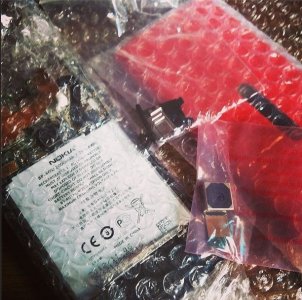

Well I update the post saying that I would not advice to do this.
A lot of dust gets into the sensor and degrades image quality significantly.
At the end I had to buy a new camera (it was fairly cheap at Ebay) and as I was having the phone dismantled, also bought a red housing for my black Lumia.
