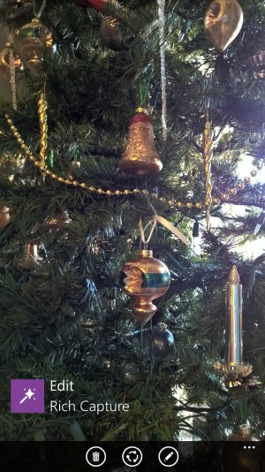

Are there supposed to be any different editing options with or without rich capture turned on?.....I don't see any.

I get an option to adjust with flash (when flash is on) only. Doesnt give me any hdr option with flash off. To be clearer, there is no edit with rich capture option. Maybe this is not part of the 950 camera software?

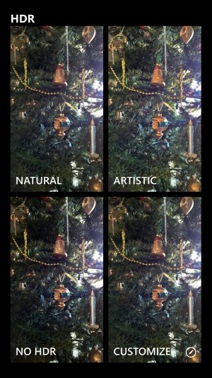

After taking the shot and entering Photos via the thumbnail, try tapping the full size image after it is done processing. It's working on my 1520. Either with HDR or Dynamic Flash, I don't always see the "edit in Rich Capture" option right away. But tapping on the pic always brings it out.
You can not exit the Camera App or the chance to edit in RC is lost. You can edit everything that shooting session though. YMMV but that is how it is working on 8.1

You can edit Rich Capture after the fact in WM10. Just go back into the Photos app and tap on the picture when it comes up full screen and click the banner at the bottom that says "Choose the best lighting".

Note, you have to have rich capture turned on. It is on the control settings, where flash and change to front camera are. It is the magic wand option. Make sure it is on.
Rich capture also only works in certain lighting conditions. And as others have said, you go view the image and edit it after the fact.

Rich capture only kicks in when it is needed, to get hdr just enable rich capture, disable flash, take a photo of a scene with bright areas and dark shadows. When there is a lot of difference between dark parts of the scene and bright parts then hdr should kick in.
