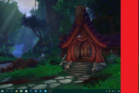

Parts of the right side of my screen have become unresponsive. It's part of the right side, with the exception of the scroll bar for some odd reason. Swipe in for Action Center isn't working, and I can't scroll or click anything in the section that is unresponsive. If I turn my Surface upside down, it's the left side that's unresponsive, so it appears to be something with the display. What do I do?
The part in red is the part of the screen that is unresponsive.
