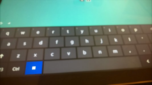

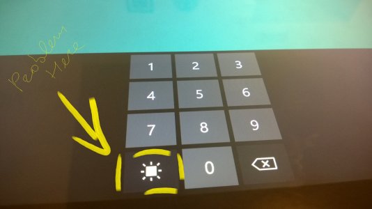

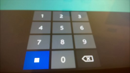

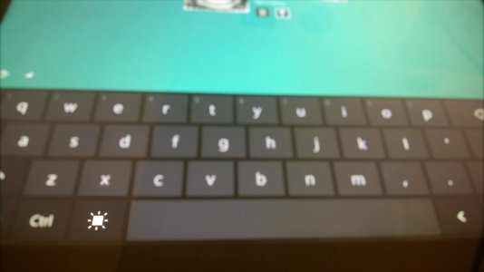

This happened to me too and I've tried everything including several restarts. Not sure why this happened suddenly.. I can't see to fix it.
go to your log in screen and look for that switch on numpad or keyboard!!!

))) idk that's how i solved my problem:))
but if you restart your SP3 and and switch between that button it will change the option in the right slide menu to brightness or screen lock orientation...
