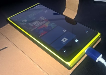

Here's the 920 with glass change. Perfect. Its only a spare / promo phone.
