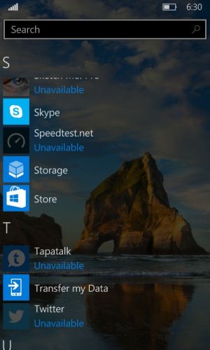

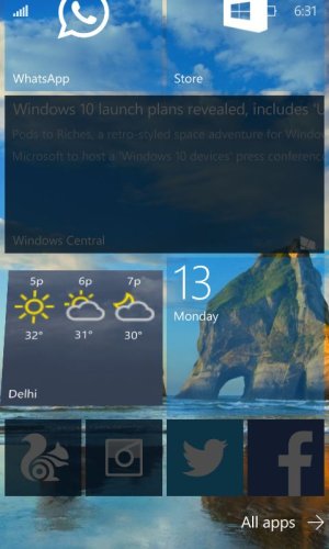

Hi there insiders !
the currently build (10166) we are running, we all know is very stable** or polished as compare to previous builds (**after hard reset)
No serious issue from me.......
But there is a one major bug in it.
As soon as when I just soft reset/reboot my phone (holly cow),,, all the apps installed in my SD-card (all beloved 14 apps) shows annoying error/crash and ultimately become useless, and make me to uninstall them ╯︿╰

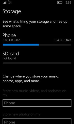

1. I've done hard reset (2 times)
2. Change SD card with new one........
....But the problem still come back! When I install new apps to sd card.
Anyone here with the same problem ?

Had this problem, had to format the sd card to get it working again.
But the fix is, when it doesn't find your SD Card, turn off your phone, wait 5-10minutes, and turn it back on, swipe up on your lockscreen to see your homescreen after 5 second. Should find your sd card, if it doesn't repeat, it works for me everytime, sometime third try...

I saw that error twice last night. What immediately worked for me both times was to power down the phone, remove, then reinsert the SD card, then power the phone back on. Everything was seen on the card with no issues.
This seems to happen only when win10mobile crashes on my phone, then I get the sd card error. Problem is, its random on when it fixes itself. On sunday, after soft resetting a bunch of times it just worked again magically. Now this morning my phone crashed and I can't get it to read again. Really annoying as I have my spotify installed to the sd card, so I had a quiet commute in this morning. Really hope this is addressed in the next update!
If soft reset or reboot didn't work, then move all the apps on SD card to Internal memory (apps with error too)
And this problem will never come back !
I have the same problem on my 535, but what seems to happen is that the app show inactive, but the effectively work!! I can receive viber messages an when I press on the notification I can use viber perfectly. But on the start screen the viber tile is dark and if I press it it says that the micro sd is loading... One out of ten restarts fixes the problem...
I really wish this error was not in the build because this is honestly the only thing keeping me from putting the Technical Preview on my 640 I have it on my 810 but since its one of my many backup phones it doesn't have an SD; therefore no error with it.
Install the apps to the phone memory for now. Installing apps to sd card isnt stable at the moment
