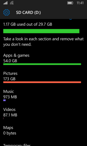

wp_ss_20160220_0002.png wp_ss_20160220_0003.pngwp_ss_20160220_0005.pngwp_ss_20160220_0004.png
Here my lumia Screenshots . To take screenshots i've to change my storage location to internal memory .
Is my memory card damaged or is this windows 10 doing ? I could clearly say my sd works i used it as a media storage. Anything stored in sd card can't recognized. All apps refuse to install or move in sd card . All files are corrupted when i insert in lumia. Until then i can access them without any issues. I even tried to insert in an Android Device to format . when I inserted my sd card android recognized sd card as errors.It ran kind of chkdsk suddenly my sd card disappeared but in pc it still shows in FAT32 file system. I don't know what to do . May be another update can solve this problem ? I would like to here your suggestions..

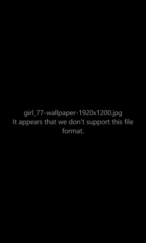

I am suffering from same problem, when I insert any file to my sd card then it shows unsupported to open. I have no option to replace the sd card , please give a solution to work it perfectly.
