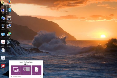

Do you have the "Send to OneNote" applet(?) enabled? See screen shot.
I had that "Send to OneNote" small dialog box before the problem appeared and "Send to OneNote 2013" printer worked as expected. But after using my sp/sp3 for about one week, "Send to OneNote 2013" printer just had no response at all.
