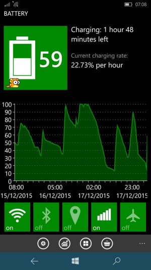

The update isn't available for me. I can't give this another week unfortunately as my phone can't survive a full day, if I can't resolve this by Monday I'm returning the phone for a replacement. The image is my battery usage when the phone has been sat in my pocket.
10% /hr with no usage is VERY bad.
Previous weeks it was like 2-5% /hr depending on usage.

What happens if you enable airplane mode?
Edit - Mine seems to have resolved itself. Not really sure what fixed it
I done this last night so that my phone wouldn't lose battery so I had an alarm this morning.
It dropped to 8.73% p/hr drain.
