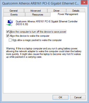

I use VirtualBox, and connected standby is still available. But when I run sleepstudy, the VirtualBox network adapters are flagged as keeping my computer awake and draining my battery.
Are any other network adapters "awake".
Any software type 2 based hypervisor (even if it is hardware accelerated) should be somewhat compatible with Connected Standby, VMware Workstation and VirtualBox are both Type 2, it is when you use Type 1 Hypervisors that Connected Standby is disabled, this is because a Type 1 Hypervisor become base system and at least with Hyper-V the Windows Installation now resides above the Hypervisor (It is the Master Client).
Yeah, the Marvell one, but that fluctuates from 10% to 90%, depending on what it's doing. The VirtualBox network adapters are always active.
Maybe the VirtualBox adapter has a "Power Management" tab like other network devices. Check your Device Manager properties on the adapter for something like this.
