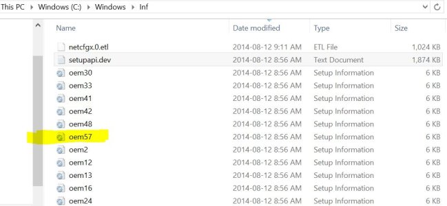

There is a Type Cover firmware update out this morning. Check Windows update for a hardware driver update. oem57.inf is the TC firmware update. The other .inf files are an update to the Realtec USB card reader.
I went to the same folder but didn't see that inf file with a date of Dec 8... Mine shows August 20, seems old? Checked Windows Update nothing there.
I was having this issue and tried everything I could think of. It updated itself last Tuesday and the issue vanished. I'm glad, but left miffed that a previous updated fully broke my Type Cover!
I have the oem57 file but it has a timestamp of 4/13. Sill having this issue as of 12/24. unplugging and reattaching as many times as it takes is still the only way to get it to work.
