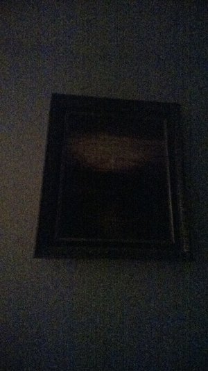

This first shot was full auto in a mostly dark room.
NOTE: the exif shows 1/3 second at ISO 5000, my manual adjustment only goes to 3200. I have not tweaked that in the registry.
This next shot, the only manual adjustment is 10 seconds exposure.
NOTE: the exif shows only 4 seconds, but ISO has dropped all the way down to 500...
So I increased to 15 seconds to see if there is a difference. Again, exposure is the only manual setting.
NOTE: exif still says 4 seconds, ISO has dropped down to 320. The subject is much more clearly illuminated.
I believe it is using the new settings, it just can't report them. I will say that the camera does not seem to like doing this prolonged (out of normal range) exposure twice in a row. I had to fiddle with settings and minimize the app into multitask screen then call it back up to get new shots that were not just black rectangles. It seems a one off use and then needs a "reset" to work again. Obviously this is tripod work, I just didn't bother mounting my phone.
