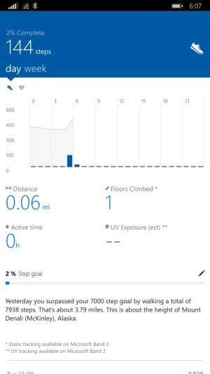

I'm having a slightly different issue with step counted. I'm getting steps counted before I even get out of bed.
This happened this morning when I first woke up. Is anybody else having this issue?
Clearly, I did not walk 144 steps from my bed to the bathroom.
I have seen that, too. Might have to do with arm movement. I can't get too concerned about 100 steps plus or minus.
Maybe you're sleepwalking.
