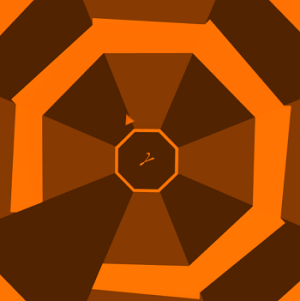

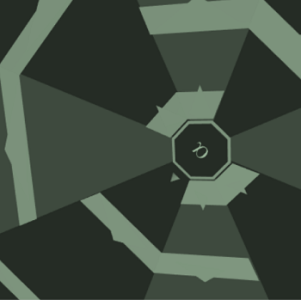

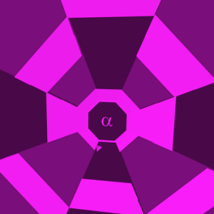

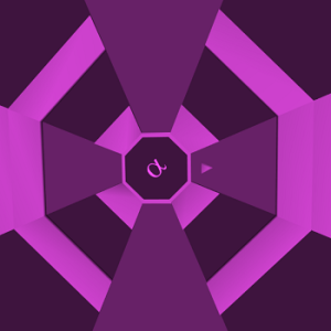

Just an update - Player triangle and side wall collision implemented. 4 Themes implemented: Flat, Dragon, 3D, Spike

3. Added 4 awesome themes: Flat, Dragon, 3D, Spikes
