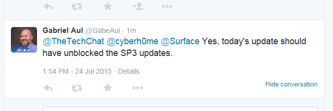

I had the same problem last night too, over and over no matter how many times I clicked retry. But this morning if finally resolved itself all on it's own. This time when I clicked it went through without a hitch or error message.
KB3074680 fixed the update. Installed it which required a reboot, one more reboot then the System Firmware Update 7/23/2015 took.
