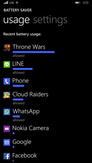

Basically look at your phone usage under battery saver (native app) and notice the big guzzlers.

Now the phone has restarted DO NOT I repeat do not go into music, photos or camera for the time being. Then adjust the time correctly and look under usage under battery saver, you should see its completely blank, use your phone as normal, no camera, music etc and then check again with the battery saver about usage, from what I've seen its really low usage.
Now open up camera, or an app such as 9snap, use it for a few minutes. Now check the usage again, you may perhaps notice a large amount of apps becoming active and will remain active.

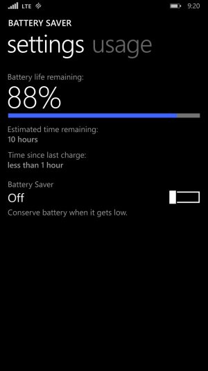

I noticed significant battery drainage on my Lumia 1520. I am currently looking at my screen with 90% battery life remaining. Estimated time remaining: 11 hours. I have Battery saver off at all time. I turned off wifi. I have Bluetooth on. I am a heavy user. I constantly play games (Throne wars and Cloud Raiders). I wake up at 7.30 with phone charged overnight (12-7.30) and I have to charge it in the office since I will be using it heavily throughout the day. Is there anything I do wrong? Why all people here could charge their phone once every two days? I am with WP 8.1, AT&T, microSD sandisk class 10. Could it be the microSD causing this? Please help.
Tried everything that I could. I just did soft reset, the battery jumped from 90% to 100%, but the estimated is still 12 hours. opened 2 mins apart, it dropped 2% to 98% now. :(((( darn it.. why?
