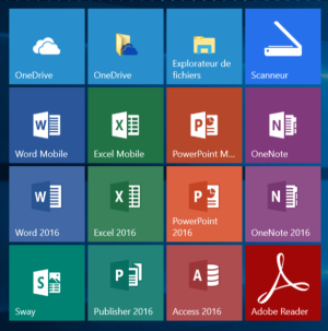

I am runnin W10 Insider Preview 14372 (slow ring).
After some time working with the computer (note: 8GB RAM) and a few sleep/wake up, it happens that my start menu stops displaying the icon on the tiles (or animations? and only show plain colors for the tiles as shown in the snapshots (normal / issue) below.
Anyone an idea?

View attachment 128398View attachment 128399

Edit: just found a workaround - switch from and back tablet mode (or opposite) - tiles are back again :-)

Note also that the problem is not permanent, the tiles' decoration/animation are shown at boot time but after some time of use, randomly (I could not find so far any correlation with a particular activity), tiles may loose their decoration/animation and show only monochrome.
As indicated, when this happened, I have now found that switching tablet mode off and back on (I am using a Microsoft Surface Pro 3) is restoring tiles' decoration/animation.
