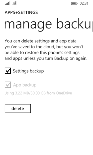

I've got text backup on, app backup on and settings backup. Photos auto upload to the cloud too. When i log in my windows account on the new phone set-up and connect to wifi, nothing happens.....i get no list of backups to restore from. This is without a sim in the new phone may i add....

first of all, make a manual backup.
this should show there is a backup in the cloud.

i've made a manual backup and it says "last backup 30 seconds ago"
i then log into my new phone under the same email address i started my old 520 in and nothing happens even when i set my wifi up during the startup process.
