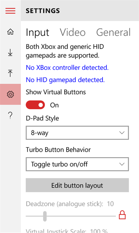

Hey everybody.
As I understood, @illdanx has gone and there is no support for vba8/vba10/snes8x emulators.
But currently I've found Win64e10 emulator that has VERY similar interface to VBA10
apps.5973.13510798887417816.ca8f147e-13d3-4a08-bc92-967584d24769.99281924-02ce-42db-bed2-e2cbc92600e0
I think that @illdanx now works on Win64e10 with MobWi team, or @illdanx just give sources of vba10 to them
Hey everybody.
https://store-images.s-microsoft.co...-02ce-42db-bed2-e2cbc92600e0?w=472&h=788&q=60
Well, thanks for the news! I really like what illdanx made with his apps so I hope he's good.
Since you showed a capture of the Win64e10 emulator I'm assuming that you've tried it. Can you tell me how is it?
