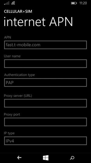

Under WM10 at the SIM settings is the active network showing as "T-Mobile"
Under internet APN do you have "fast.t-mobile.com" set?

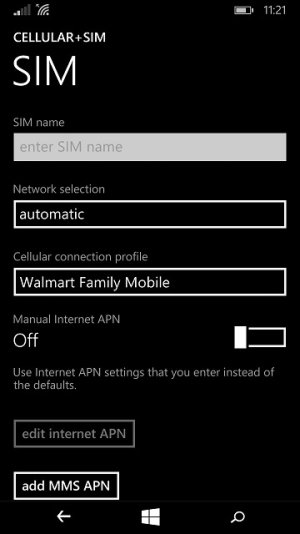

I use ATT unlocked 640 on Wfm with data plan. Works fine, and I don't remember doing anything special for it. Couple of screenshots below.
My data hasn't worked from day one. I've done 2 hard resets, every possible combo of APN settings. Bob, what are your settings? I still have 2 of the phones running 8.1. I haven't flashed mine over to Tmo yet, but I wonder if that would help me to get the setup I need to make the data work.
My phone is using "Default APN Activated" which does not allow me to view any settings. So whatever the defaults are for TMobile are working.
