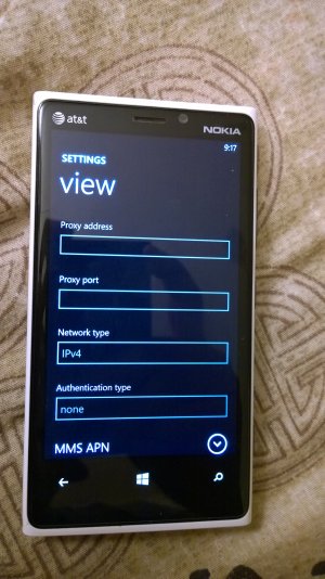

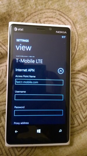

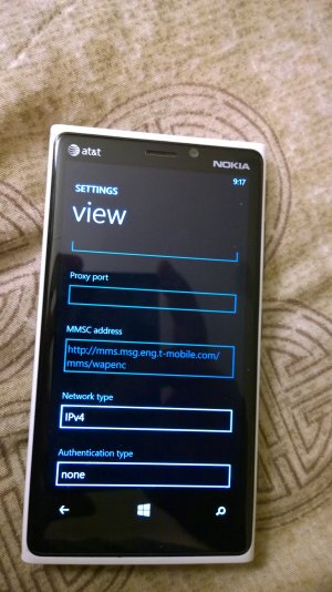

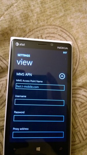

Hey! I own a Nokia L920 on t-mobile also. Mine is an unlocked Rogers.
I used the access point app and it looked like it was working but it actually wasnt. I created my own access point though through the app using the address epc.tmobile.com instead of the fast.tmobile.com variant for the LTE network.
Internet APN: epc.tmobile.com
Network Type: IPv4
MMS APN: epc.tmobile.com
MMSC Address: http://mms.msg.eng.t-mobile.com/mms/wapenc
Network Type: IPv4
Leave everything else BLANK!
After you input these in the access point make sure to turn off the phone and turn it on to see if it works. I still get LTE with these settings, so it should not affect that. I had to screw around with it a bit before it worked. Make sure you have your data on also before sending or receiving MMS's.
Hope this helped!

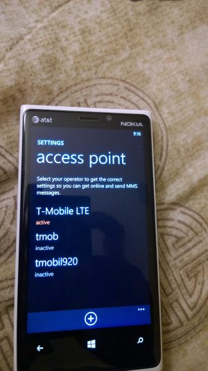

I would delete any APN settings you have under "Cellular" Download "Access Point" from the app store and input the APN settings I listed above.
Thats what worked for me!

Access Point should solve the problem. I have a Rogers 920 and everything worked fine for me once I installed it.
I have an unlocked 920 from India on T-Mobile..even I had a similar problem. Got resolved today by contacting live chat. They asked me to switch off my phone, remove sim card and refreshed my settings from their end. Yes they asked to delete as many msgs as possible before the troubleshooting.. Things r working gr8 since then..You should try it.
Thank you for this. At first I couldn't find it, and technical support was no help (they told me I wasn't getting the MMS images because the lumia 920 was lacking a certain band which it actually isn't lacking. Thanks T-MOBILE!). Turns out if you have an ATT phone that was locked (which I had unlocked by paying the ETF fee) you will not find access point in the store. So I had to download it using windowsphone.com onto my phone. After that I could finally get texts and such from T-Mobile. Would have never thought to do that till I saw this thread. Thank you for helping me finally fix what T-Mobile could not figure out.
