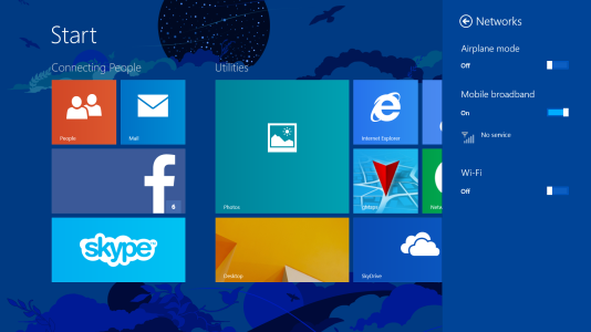

Does any one know how to unlock a the Verizon Lumia 2520? My goal is to unlock the Verizon 2520 to have it used on T-mobile's network with the Uncarrier promotion (free 200 mb of internet). I mostly use the tablet at home with WiFi but would like to have the added capability to use it on T-mobile's GSM. Although, I'm perfectly happy using the tablet on my WiFi only.
I've called Verizon several times to confirm that the tablet is "unlocked" but it seems that most Verizon reps say its "unlocked." I was able to speak to T-mobile to obtain a tablet SIM card and placed it into the Verizon Lumia 2520. When I open up the settings to view if I have mobile broad band but it shows as "No service." Just to make sure we're all the same page, the T-mobile SIM card is active and registered as mobile broad band for tablets.
Does any one have any advice on how to unlock this device? Suggestions?

I'm not sure... I was able to confirm with T-mobile that the mobile broad band SIM card is active but when I insert it into the device it clearly states "No service." Any suggestions? I guess I will try calling T-mobile to force the SIM card to use band 4 LTE... It's worth a try.

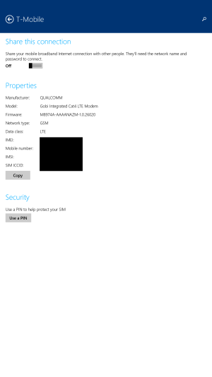

Today I test my Verizon Lumia 2520 with Verizon 4G LTE SIM card and China Unicom SIM (GSM/WCDMA). I can say that the verizon Lumia 2520 definitely have the GSM/WCDMA build in. But the tablet don't have the software and apn support.
