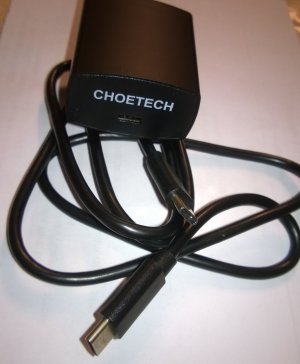

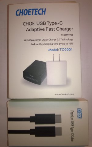

I would recommend getting the cables from a known brand like Choetec or Anker. I recently got USB C cable from Choetec and have no problem using it to charge my 950XL so far.
Edit: Here are some pictures of the charger and USB-C cable from Choetech.WP_20151224_17_13_14_Pro.jpgWP_20151224_17_11_06_Pro.jpg
