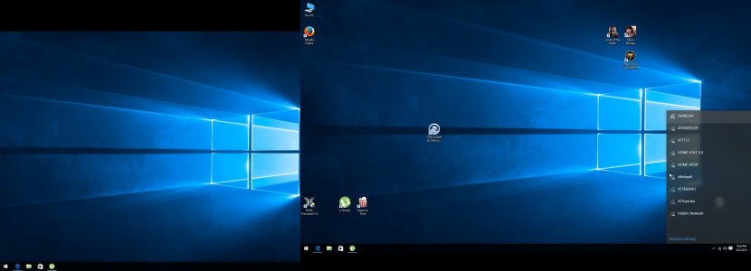

I'm experiencing slow wifi as well after upgrading to windows 10 pro. I cannot get utorrent to get over 950KB/s and when I have utorrent running using that bandwidth, everything else is slow as well. Loading webpages, videos, etc. One possible thing for me is I'm using an old trendnet wireless adapter (tew-624ub) which doesn't have windows 10 drivers yet, unfortunately. That may be the reason at least for my slow speed. Windows is using 802.11n wireless lan card for the driver. Its like I'm capped at 1000KB/s.

So I installed the trendnet utility for my usb card in compatibility mode for Win 8 and it installed fine. It disconnected me from the Windows 10 wireless settings and I connected using the utility and instantly my download speeds went back to normal with utorrent and browsing while utorrent is downloading. Weird the driver is still the same default driver windows 10 used after install, but its working. My suggestion is try your wireless usb utility and connect using it. Seems to have worked for me.

Hazard - Your wireless usb device will usually come with software or if it didn't you can usually download it from the manufactures website. They will usually include a utility program that manages and monitors the wireless connection. The pics should clear any confusion, but I'm not sure if that is the problem or not. I just tried connecting using the windows wireless connection and my speeds were almost normal. Its still worth a shot though. I noticed a windows update today 8/5/2015 (KB3074678) not sure if that had anything to do with fixing it today or not. Let us know if you get it fixed or not. GL!

Sorry the screenshot captured both my desktops.
