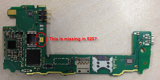

Okay so while my data connection was down, Perhaps this is some evidence, Internally
I looked over the FCC 521 Pics (Select Internal Photos)
Download in 520 Service Manual. go to Page 11
Visual Pic of Internal showing difference between 520 and 521.
Where the camera is located at on the 521. To the Right of the Camera Lens itself some type of sensor, On the 520 does not exist. So that extra notch right below camera on shell is for something after all.
The extra length on 521 probably comes from this. One of Chips along the bottom is arranged differently on the 521 then it is on the 520.
On 521 is running left to right. On 520 you can see that is running up and down.
You can tell from the pics that 521 board is different than the 520. Notice the notch on the 521 right above that chip running left to right, not on the 520.
Now the Mystery Is Solved I believe
your thoughts.
I would post edited images from the pdf but they are copyrighted.

so its a sensor. I couldn't tell if it was some extra mic (someone around the forums or comments, either/or, suggested such) or a sensor when I took off the battery cover.
Im guessing its some kind of light sensor? Perhaps the 521 has slightly improved on the 520's camera for light sensing, seeing as it has no flash?
your thoughts.

Correct, that small sensor is not present on the 520. That Notch has well right above the chip running left to right.
From what I looked at on FCC site the 521 went through twice, the first time was in Feb right around when 520 went through, boards where identical. But in March the 521 went back through
FCC testing with a board from above.

But that shouldn't affect the LENGTH, right? :confused:
Sent from my Nexus 4
Actually, it can. If, on the 520, the circuit board (where the gap begins) stopped directly underneath the camera, that sensor adds, well, the sensors length, to the device. Meaning it appears that the 521's added length is for a camera improvement (light sensor, which is needed, seeing as there's no flash, so low light is key), not just some silly branding (which I personally like).
