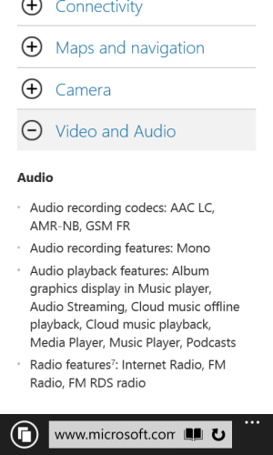

Here is a list according to Microsoft of accepted music formats for your phone.
