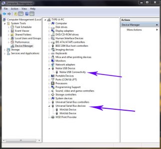

Hello, I am having same problem with my Lumia 720. I never had this problem until recenlty. then i noticed if i connect to another computer my phone gets detected immediately. However, other phones get detected on my computer except for a 1020 i tried connecting. so I should say windows phone is not connecting.
I went to computer manager as you suggested but i get a blank page under device manager. any other way I can go around this? thanks.
