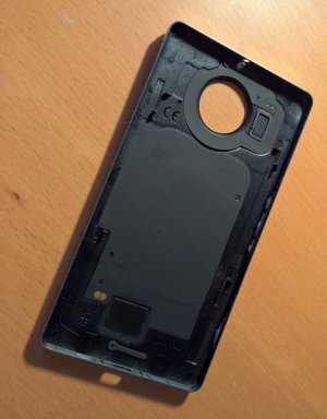

Just wondering if the height of the 950 XL would be too high to interface with the wireless charger. In other words, how close does the Qi area on the back of the phone need to be to the "active" area on the charging stand to work.

Whether it works or not varies from phone to phone. I have a couple DT-910's, and I have, or had, many phones with wireless charging. It works on the Lumia 920, Samsung Galaxy S4, and Nexus 6. It does not work on the Galaxy S5 or the S6 Edge. Evidently the coils do not line up.
I would think it should work with a Lumia, but there is the possibility that the placement of the coils in the 950XL was not designed around it. Basically, just try it and see if it works. Or wait until someone else does.

My DT-903 and MD-100W charge the 950 XL just fine.
My DT-910 and CR-201 do NOT charge the 950 XL at all.
My older Lumia 1520 worked on all those four chargers listed above.
The old horizontal plate has three Qi coils in it, making it easy for the receiving Qi coil in the phone to get a good "connection" even if you put the phone on the plate a bit off center. The vertical stand has only one coil since, by its design, one can't place the put the phone off center (since gravity pulls the phone down to the bottom of the stand). Thus, the design of the stand require that all phones placed on it have their receiving Qi coil at roughly the same height from the bottom of the device. The coil for the 950 XL is not at that height.
Turning the phone to landscape works, but you have to place it very carefully to get good coil alignment. I place it with top of the volume up key just about 3/16" (4-ish mm) right of the left edge of the stand. This seems to start charging and prevents occasional disconnect/reconnect events that cause the phone to make the "I'm charging" sound.

I got the DT-910 charging and the trick, although really slow, is to have your Lumia 950XL standing sideways in a horizontal position. I think a better use of the DT-910 is as an overnight charger by my bed. I'll see how it goes tonight ;)
