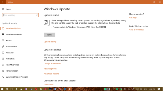

I am trying to update my windows 10 to Falls creating update but am facing some problems.
I am using Windows 10 Home single language, Version 1703, OS Build 15063.674
Using automatic updates, the system is downloading the updates and installing.
First installation takes about 15 min to install and then when it reaches 100 %, second round of installation starts which is quite long. 2nd round of Installation takes around 1 hour to reach around 20 % and the following error comes
“Feature update to Windows 10, version 1709 - Error 0xc1900204” (picture attached)

According to what I've read, that error code indicates a failure during pre-validation - specifically, wrong SKU or architecture. I'm not sure how that would be possible if you're upgrading through Windows Update. Maybe your installation is faulty?
