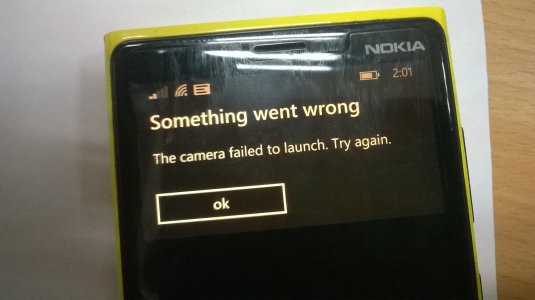

I have the same problem, but since the second devpreview update i think after 8.1. I just turn back to 8.0 thinking that the problem will be fixed but nothing, anyone solved this?
Lets think of the resets in layers. Top layer is a soft reset, it just restarts the phone. Second layer is a hard reset, it removes all personal information. The third layer is this one, it factory resets your phone completely, probably why it isn't mentioned that often here, usually a hard reset fixes most issues.
Well that didn't work either, is there a fourth layer reset? xD
My phone is hopeless
