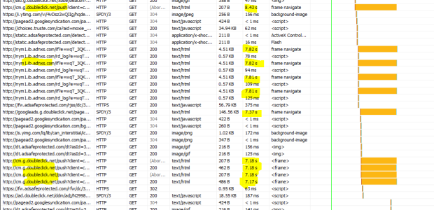

Many ad services take 10 SECONDS to load.... and you add a bunch of those up == VERY SLOW SITE

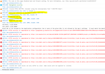

Site contains basic HTML errors.
Edit: Note, HTML errors are important to fix because web browsers have to 'guess' on the HTML which often requires waiting for more of the page to load and so slows down page rendering

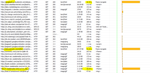

James. I posted some evidence of slow page/ad loads showing which services are causing the issues. Let us know if you need more information, but I don't think it's hard to see why the website is slow. This is standard Win8.1 with standard IE11 on a fast connection.
