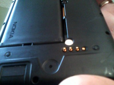

When I put the phone on the plate the charger LED went from red to blue, but the phone indicator didn't show that it was charging.
I investigated the problem and discovered that one of the 4 contacts inside the battery cover was different than the other 3.
I'm fairly certain this is causing my charging issue.

Here's my phone:
It seems like a very strange defect, and one that should have easily been caught.

It's broken (the pin), that's why it won't charge, it needs all 4 to charge...
I don't know how you managed to broke the pin...

I received the phone like that.
I had it for a week waiting for my charging plate to come in the mail. When the plate showed up and I tried to charge it I discovered the defective pin.
It doesn't look broken. It looks smooth like it was made that way.
Seller is exchanging.
The solder's not a bad idea troy, but since I have a short term warranty with the seller I'm going to go that route.
Besides - to heat that contact enough to melt the solder would probably melt something behind the contact as well - and that could be bad.

It was definitely broken and don't try to fix it...

I was just thinking melt a small drop onto it. No actual modification to the phone. If you have warranty though, return it.
I was never going to try to fix it. I was just trying to respond to Troy politely.
It's definitely not "definitely broken". Internal physical damage to a new phone doesn't make any sense at all, but a defect in the manufacturing process does. I'm sure those contacts are stamped by the thousands - and I'm sure there's a certain percentage of defective parts. Unfortunately one ended up in my phone. Unless, of course, you're the blurry photo whisperer and can see into the past.
The phone came from Hong Kong - it's probably a factory 2nd, or worse.
