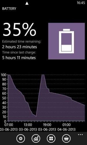

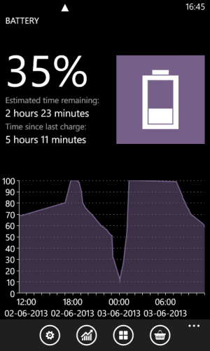

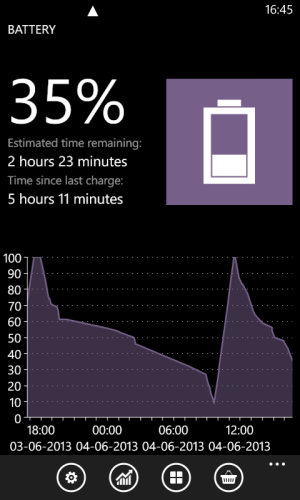

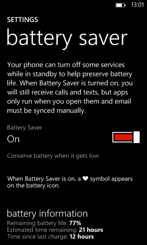

i am running OS version 8.0.10211.204
the pattern that you mentioned is not a one of thing...
see
this last one is todays when i switched off the net
what is the battery back up that i should expect..
also.. will updating the os solve the purpose...?? is a new firmware out as yet???

These looks like the same screenshots you posted previously. Please REMOVE WhatsApp and see how your battery life is then.
Updating OS will probably not solve your issue, your issue is much more likely app related. Please REMOVE WhatsApp and see how your battery life is then.
You should expect a full day or more of use from your phone with moderate use, depending on the cell signal strength. Please REMOVE WhatsApp and see how your battery life is then.

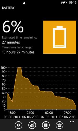

Ok So here is the deal... i went yest... and as ozROB mentioned.. did not install Whatsapp... and i got arnd 15hrs and 27 mins of battery....
further....
came across this... We put the Nokia Lumia 620 battery life under inspection, boasts class-leading call times - GSMArena Blog
and when you mentioned more of calls and texts this gsmarena site explains why it fares so badly when we put whatsapp cause that drains the battery..
so is it that officially this cell is not ment for heavy net users but does well for other stuff such as mail+call( most imp) n little bit of surfing??? by which i am asking now after the reinstalling of software (and deleting whatsapp) IS my battery normal..?? or do i need to replace it????

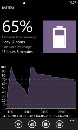

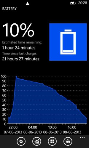

Yes... it improved..if i had not beeen on IE it would have easily given me over 24 hours... i noticed two things..\
A. The cell mattery charges very fast ( i have not taken more than 1hr 15mins EVER to get it charged even from when it got fully discharged so much so that it got turned off)
B. if you see my prev snapshots all the severe drops ( at 2300 hrs above and at 3 am and at 20% levels are when i was browsing or using the net in any sense.. (and as i had mentioned above.. We put the Nokia Lumia 620 battery life under inspection, boasts class-leading call times - GSMArena Blog)
i think the cell is not for heavy net users... one would need tto charge midday... but if one is primarily calling/texting it will last over a day for sure.. OzROb can concur with me... if one uses the net battery falls like rock in clear water.... when i switch data packet off it shows me .. 2 days remaining to 5 days remaining depending on my charging level...

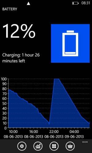

Off late have been experiencing very erratic battery timings.... two days two similar usage...
brilliant with over 20 hrs of back up with decent net usage...charged at night went on till next day..evening
and other day (yesterday night) did same and when i woke up it was off
FYI: had installed whatsapp to see the difference with and without it.. both days had it up and running to see...
will be going for cell replacement since its wayyy tooo erratic
