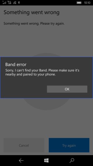

I'm running into the same issue. Hell of it is, I had it all working last night with no problems until I had to hard reset my phone to get the Lumia Offers app to work.
Here is my sequence of events:
I go through the steps, everything works fine. The phone sees the Band, the Band sees the phone. I grant it permission to show notifications, etc etc.
The phone proceeds to the final "Getting Things Ready..." step, this message is displayed on the Band and the App.
Then, even though the pairing process is completed and the phone is connected to the Band (I confirmed in Bluetooth settings), I get this error message. Every time.
Things I've tried to resolve this:
  • Reset the Microsoft Band 2
  • Uninstall Microsoft Health
  • Remove Microsoft Band 2 from the known devices in Bluetooth menu
  • Check for updates on the Microsoft Health app
  • Performed another hard reset on the phone. No luck.
I'm truly at a loss for words since I had this up and running fine before I had to do a hard reset this morning. Any additional suggestions would be wonderful, I feel like I'm losing my mind.

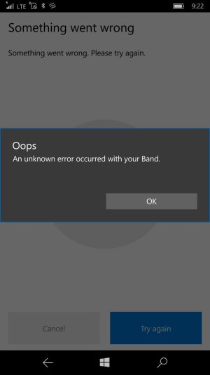

Thanks metsfan421 for the comment but unfortunately it looks like there are two different problems that most people are experiencing. The one you had was a pairing issue "band error" that can eventually be resolved with some persistence. Then you have the getting things ready... error 'oops' that I've yet see anyone solve or get past so far.
I don't know anything about anything but my gut is telling me this is either a 'cloud' setting that we've stumbled into or an actual Windows 10 mobile MS Health App bug/issue that we can't get past.
I'm resigned to just waiting for someone to fix it or come up with a new set of things to try. I spent a few hours trying different combinations with the PC sync app, my android app and my windows mobile app to no avail.

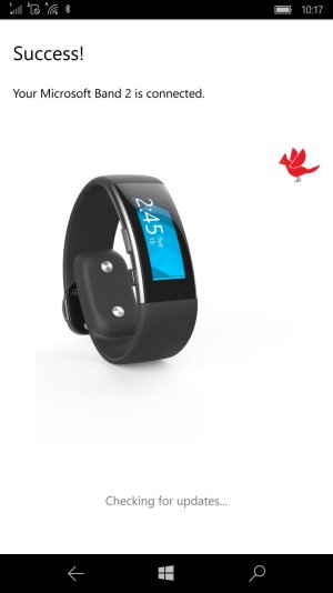

Here are the steps I followed to get mine to finally work:
Just got it to work.
In my situation where I could always pair my Band 2 to my Nexus 6 without fail I followed these steps to get my Band 2 to finally work with my Lumia 950XL.
1) Start Add Band process on my Nexus 6. On my Band 2 I selected Windows Phone instead of Android (Not sure this is needed but it seemed logical to me).
2) Finish successfully adding the Band to my Nexus 6 and turned off Bluetooth on my Nexus 6.
3) On my Lumia 950XL I uninstalled and reinstalled MS Health App and I had the My Microsoft Band option but when hitting it you can't actually see the Band 2 information.
4) On my Band 2 I went to settings and Bluetooth and turned it off, turned it to 'pairing' and it asks if I'm pairing to iPhone and I said no. Waited for pair between 950XL and Band 2. After successful pairing I went into MS Health App and I am able to use everything just like on my Android but now with the added ability to use Cortana.
I'm thrilled, and hope this works/helps for anyone else in the same situation.
-Phil
