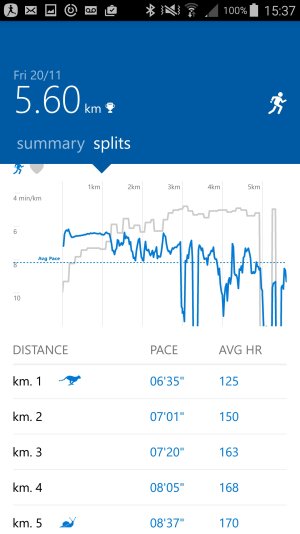

I used my Ms Band for Treadmill running (rather a jog actually) last week for the first time and realized distance accuracy was very poor. So I calibrated it with GPS on outdoor run and used it for the second time this am.
Still the distance accuracy did not match the treadmill distance - but I can live with that.
What made me feel truly depressed was - I started with speed setting 9 and after first ten min (on a 50 min Run) I kept on increasing the speed each three min or so and ended with 15.5.
So practically i ran my heart out during last 10 min.
At the End of the run guess what I saw ... on the APP...I saw a Cheetah during the first 10 min and a Snail during last 20 min- I felt like to throw Ms Band from the 4th floor window in my gym ...then again I paid ?99.00 for this plastic.

In fact, if I can post the graph given by the Health app, it looks rather strange, my heart rate is going up nice and steadily but my pace is getting slower and slower to the point the app displayed a Snail.
However in real it was completely the opposite.

I think you may be misreading the graph. If your pace is calculated as minutes/mile then going "down" on the graph would indicate a faster pace. Could you post a screenshot so we can see what it looks like?

Thanks for helping me buddy
See the attachment and note the Snail by 5th Km, that's the time I was running.. My heart out...

Treadmill for any device is never going to work for speed changes. All that any device can count is the number of steps and then translate that to speed based on the calibration. When I run faster, the number of steps per minute doesn't change much, but my stride length does. MS Band or any other pedometer type device (I used to use the Garmin foot pod) can't pick that up.
