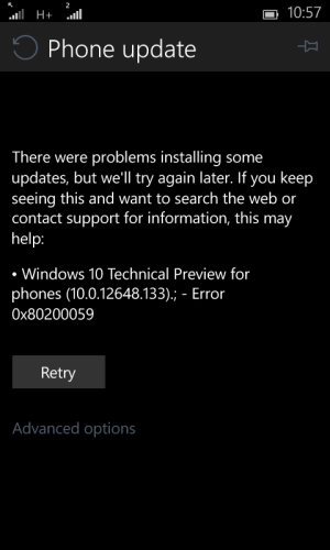

My phone update shows:
Updates are available....(10.0.12648.133)...
Downloading updates 0%.
The downloading updates stays for about 30-45 minutes at 0%, it never changes.
Then it switches to preparing to install, and it sits there for about 10 minutes.
Then it says ready to install and has a scheduled time. When I click 'Restart now' everything on the update pages goes away except some red text saying:
"There were some problems installing updates, but we'll try again later. If you keep...(0x8024201f)"

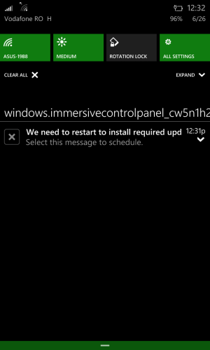

Worth checking out how this title in the notification looks, is it the same for all of you guys?
If someone finds a fix for this or it just randomly fixes itself please post here, as i'm too lazy and a little bit busy atm to flash back 8.1 and even if i flash, who knows if it will work...

Eventually, after multiple reboots, soft resets, and re-selecting Fast ring, the phone recognized that the update is available.
But the same errors pops up.
Here it is the error message verbatim:
again later. If you keep seeing this
and want to search the web or
contact support for the information,
this may help - (0x8024201f)"

I'm getting the same error when the update fails from the start, and also when it works (dl + prep) after I press the reset button, I get the same for a very short amount of time. I also remember getting 0x80240022 at some point, don't know exacty. Seems like we aren't getting this build either.. :cry:
EDIT: I only got to the cogs once in all my attempts, so probably something broke there. And I also had a short period when it told me it was up to date.
@salcie
That's correct. I also recall seeing 0x80240022 error at some point.
