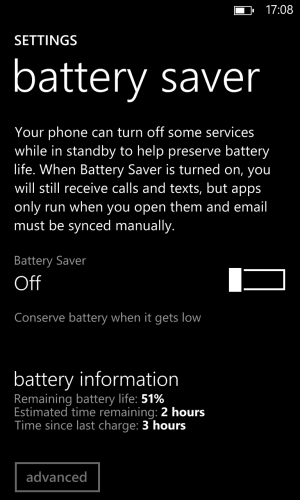

So I just got my 1020 Yesterday. Have been having really bad battery life, I am at 50% within ~4 hours. I did a charge to 100% last night with the included charger.
I installed a battery app and it says I am draining at ~7%/hour.
What has been the consensus, so far, for steps to take to improve battery life/determine if unit needs replacement?

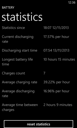

So ive come to the decision to drop it off at a care point and see if it can get fixed. On the phone atm and will attach a screenshot of how terrible the battery is.
i mean i cant have EVERYTHING off defeating the whole purpose of having a phone with all these features. Its also a big thing if we're reading abt users who have wifi, glance, email syncing in the background and actually lasting up to a day!
so shall give you all an update on whether its worth doing. Also considering itll be within the warranty (2 yrs) its definitely worth a go.
JK
So here's how terrible my one is. Again I reiterate I did use the phone with the only thing on being data connection. Wifi, bluetooth, glance, tap to send, brightness, email sync are either set to off or low. just thought i'd show how bad it actually is!
I guess u have a defective. Battery...nokia will solve it.
Sent from my RM-875_Lumia 1020 _india_using Tapatalk
