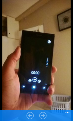

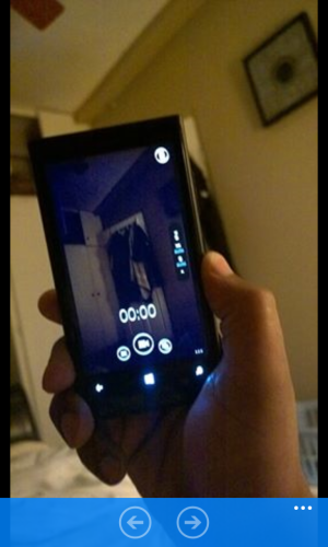

I tried some video recording in my dimly lit room and can't see anything on the 1020.... example...
This is what the 1020 sees...
This is what the 920 sees...

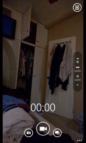

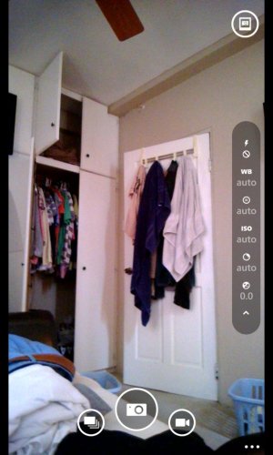

Took some screens shots here for comparison again....
1020... Why is it so dark and noisy.. Look at the lines at the edge of the screen too....
920...

it is because 920 has aperture f/ 2.0
where 1020 is f/2.2
if you buy 720 it will be the brightest in low light because it has f/ 1.9

so you're saying its normal?
what about the lines?

you have vertical lines on video, and my lumia has horizontal lines on video, now the question is whether it is a software issue...

I think its because i was holding the phone in portrait and you , in landscape :)

As Dexterrino mentioned, the 1020 has an f2.2 aperture whereas the 920 has an f2.0. This is to address the 'softness' of photos that users originally complained about - in a nutshell the lower the aperture the more light is let in but the softer the photo; the higher the aperture the less light is let in and the sharper the photo (generally). Furthermore I reckon the lines are there on the 1020 (I've noticed this too) because the phone simply hasn't been around as long - in the past two years there has been a lot of time for the engineers to refine the firmware for the camera on the 920 whereas the 1020 has only been out for a year.
In fact, not only 920. I was having a 925 before my current 1020. And I can see much brighter on the viewfinder with the 925, but is pitch dark for 1020. Not sure if it is due to the F2.0 of 925. But 925 indeed can result in much brighter images for dark places as compared to 1020.
