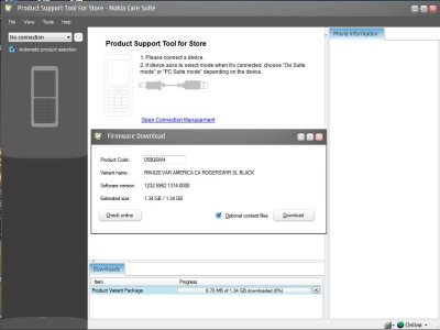

I am downloading the 1314 via Nokia Care Suite as below:

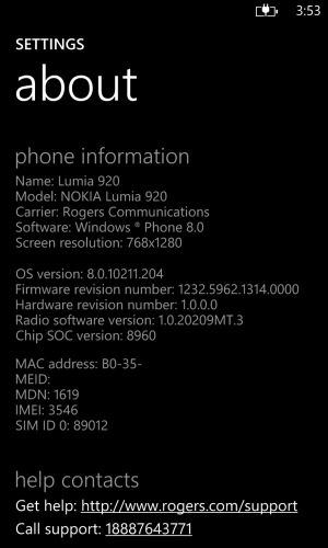

I have no issue with 1308 cause I added the Access Points to allow the FULL capability of Text and MMS service on TMO while I need to SACRIFY the use of Internet Sharing.
Right now, after I updated to the 1314, I disable to installation of ACCESS POINT to regain the Internet Sharing capability to allow connecting to 8 devices but the issue I am having now is the MMS is not working at all.
Have tried several MMS settings but could not find any to allow sending of MMS.
For security reason, I have removed partial information regarding the physical address of MAC and SIM from the above screen capture.

Uh, the one announced by this very thread:
RM-820 VAR AMERICA CA ROGERSWIR SL BLACK 1232.5962.1314.0000
