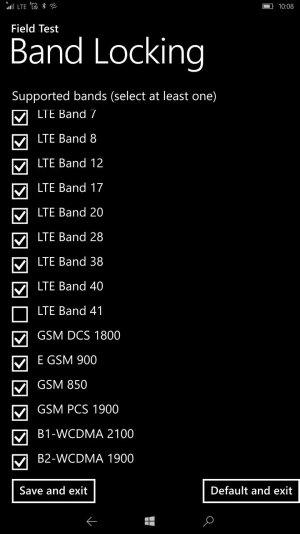

So I am not sure who all knows about this, but apparently LTE Band 41 is disabled out of the box. It is easy to re-enable it (although doesn't really matter on AT&T since they don't use that band, this should be a Sprint band). Go to phone dialer and enter ##DATA# and it will display field test. Under settings there is an option for band locking. That will then let you enable/disable various bands. Band 41 is the only one that is unchecked.
Not sure this really matters to anyone, but thought I would mention it.
enter ##DATA#

Technically speaking LTE bands 2 and 4 should work on Verizon, but their main band 13 is not supported. So no, you cannot activate the phone on Verizon (besides you would have to convince them to let it onto the network and I don't think anyone has been successful talking to Verizon). So I agree with RumoredNow
There should not be any negatives for turning on additional bands. Even if the phone does not end up using those bands it should not cause any kind of problems. For what it's worth here are the cell service providers that support LTE Band 41 in Asia:

What if i enable only my country LTE bands? (28,4) It will eat less battery?
I actually thought about that and I went through and disabled all bands except for those that AT&T uses to see how the battery does. I could not tell any kind of difference. But it has only been 2 days so far since I did the change.
Anyways, give it a try, but I would not expect much if any battery improvement.
Probably not.
What you could do, if you are in an area where your data signal wavers between H+ and LTE is disable the H+ Bands or disable the LTE Bands to force one connection speed throughout.
Battery is impacted by shifts between data speeds and search for signal lock (handoffs). Your device won't try shifting between LTE it can "see" and LTE that does not exist.
Tried the ##DATA# on my Lumia 950XL and it gave me an error. I have the Single SIM International RM-1085 variant of the 950XL and I'm on USA T-Mobile. It actually looks like it tries to gather up the field data, but then pops up an error message. Oh well.
That's probably due to your specific firmware. Apparently some firmware's don't allow it
