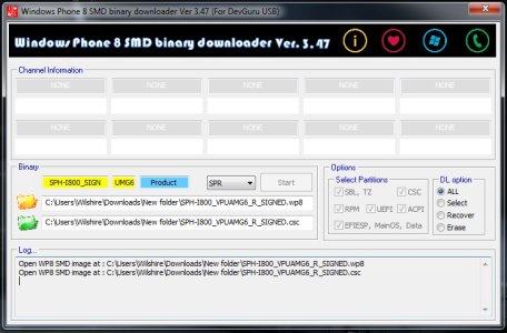

Well I cannot get it to work. I tried installing the USB drive before and after the re-flash tool and he start button never activates. Also every time I plug the phone in I get a strange tone.

Windows 7 users seem to have better luck with the driver included with Kies. You can download just the driver here: http://nuangel.net/pcdownloads/SAMSUNG_USB_Driver_for_Mobile_Phones.exe
This was discussed in the comments of the article where I give step-by-step instructions for the solution: FIXED! Sprint ATIV S Neo Developer Preview 8.1 Unable to Activate after Reset | NuAngel.net

I tried to use NuAngel's procedure to re-flash my phone firmware. I downloaded the package an un-rared it on my Windows 7 computer and installed the Samsung drivers (successfully). I put my phone in download mode and plugged it into the computer. Windows 7 says it isn't a recognized device. Needless to say I can't reflash the phone.
Any suggestions?

I had the same issue. What worked for me was to go into Device Manager, right click on the Ativ S Neo icon, and select Troubleshoot. From there it indicated it needed to install new drivers, so I clicked Apply Fix and it fixed the problem.

Thanks Skippy. If I open device manager it is listed as "Unknown USB Device)". There is no troubleshoot option. If tried right-clicking and select update driver software, it tells me the driver is up to date (using search Windows update) or Windows can't verify if this is the right driver if I brose the drivers and choose the Samsung mobile USB Composite device.

Yeah, not the same issue I had then. Not sure what to tell you. Maybe try to find the drivers and manually install them, then plug the phone back in and see if it recognizes it as the Ativ S Neo.

See the comments on the bottom of my page, there is a 2nd driver which seems to work more reliably for Windows 7 users instead of the driver included, which seems to work better for Windows 8 users. I have a link to the Windows 7 driver in the comments of my own page.
