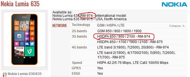

Hello,
I bought a Nokia 635 recently. But its not working on Wind. Can you tell me what you did to make it work. I changed the APN and MMS, didn't help. Customer Service doesn't how what to do. Can you tell me what I need to do please.
Hello,

The phone is not branded. It is unlocked.
Manufacturer Name:
RM-974_1076
Mobile Operator:
O2O-GB
Configuration ID:
1076.00BD21
Core Build ID:
6130.51
IMEI-SV:
<snip>
BSP Release:
1061.0066
Active Customer Configuration:
12075
Master Configuration Label:
14wk23_1
Preloaded Content Label:
14wk23_2
Application Version:
3.9.2.1
Build Creation Date:
2014-07-31
MADE IN CHINA
FCC ID: PDNRM-974
Please don't ever post your IMEI on a public forum... I edited it out for you.
If you can not even make a call... The phone is not necessarily locked.
https://dev.windowsphone.com/en-US/OEM/docs/Customization/Registry_values_for_mobile_operator_IDs
If it is unlocked you still have issues as Wind does not run any GSM (2G) only 3G/H+...
https://en.wikipedia.org/wiki/List_of_mobile_network_operators_of_the_Americas#Canada
Your phone does not have 1700 MHz on the WCDMA / 3G / H+ radio needed for Wind.
Your phone is physically incompatible with your service. Sorry.
