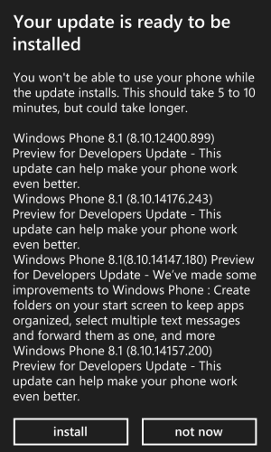

My 920 dev phone with latest dev preview update, rogers rom on tmobile usa just got cyan. There's also another update that I'm getting after cyan but my battery level is pretty low after the cyan update to install it. I'll have to wait for my charge level to go up
