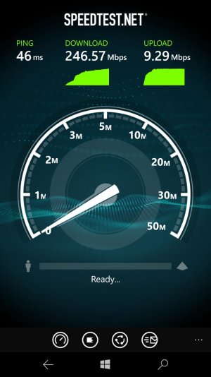

I have had no issues with either 5ghz or 2.4. I am using an Amped Wireless Athena router. Here is my latest speedtest on 5ghz:
