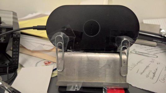

I took my dt-900 that I got from ebay for $10 and took a business card holder and taped it together. It works as a makeshift stand and actually better than my 910
